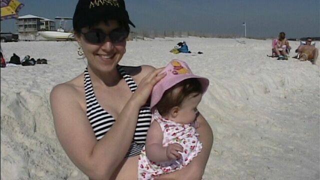

  11. As others have mentioned on this forum, when you record a DV stream via firewire with the DR-M10, the results are excellent. The conversion from DV to MPEG2 is outstanding. Plus, if your DV footage was shot in 16:9 mode (if your camcorder has this feature), the 16:9 flag is also transferred to the DVD recording... it plays back in 16:9 on your DVD player automatically.
    Here's a frame grab from a DVD-RW I recorded in XP via firewire from a MiniDV tape I shot with a Canon Opture Pi in 16:9 mode. I resized the frame from 720x480 to 640x360 for posting. When played back on a regular DVD player (or with Power DVD on the computer), it automatically is in 16:9 format. Anyway, the DVD copy looks virtually identical to the original MiniDV tape... I can't tell any difference.
    Of course, DV stream conversion to DVD bypasses all the analog filtering and processing the DR-M10 has built in, or any external processing. In the case of this scene, I normally would capture it through the analog s-video method instead so I could use a proc amp to adjust the image a bit (since it is not lit very well).
