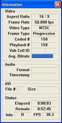

    I have a screanshot from DVD2AVI, does anyone know why it says NTSC??
  9. Originally Posted by gastorgrab
    Originally Posted by bugster
    If it really is 50 frames per second progressive, then the only thing I can think of would be to use avisynth to select every 2nd frame, then use this to framserve to an encoder. I doubt you could find a way without re-encoding, but I could be wrong!
    Something like this i'm guessing;
    SelectEvery (4, 1, 2)# Assuming TFF
    Weave ()
    Would there be a problem with Up and Down shifting?
    I am no avisynth expert, but I don't think that would do waht I was think of. I don't see the need for weave() if the source is really 50fps progressive as the OP seems to think it is.
    Simply SelectEven() or SelectOdd() would be sufficient. You might want to use AssumeFrameBased() at the start of the script just to be safe.
    I have to agree tho, 50fps progressive does seem unlikley
    There are 10 kinds of people in this world. Those that understand binary...

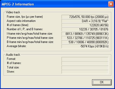

    Here are the VirtualDub information:
    If the frame rate is 25fps, and the header tells the software that it is 50fps, then theoreticly, the play time should be halved, but it is not. All information suggests it is 50fps.

  15. Originally Posted by minchjp
    You would have thought so wouldn't you!
    If it truly is 50frames per second, then as I suggested above, avisynth can select every second frame and the frameserve to an encoder. A little easier is virtuadub mod which IIRC has a built in 'decimate' filter which I think does the same kind of thing (not sure about that tho).
