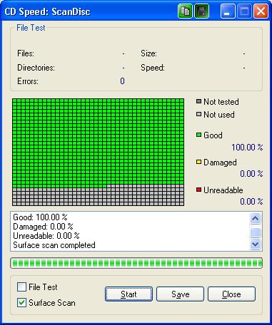

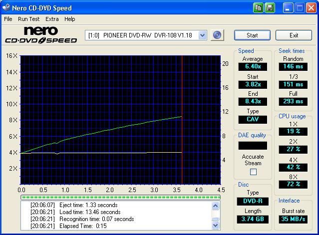

    Here's the info from the latest batch. Burned 10 so far no issus. All 10 scans with Nero CD Speed are good. Also watched one last night and works Great.
    http://www.rima.com/Merchant2/merchant.mv?Screen=PROD&Store_Code=R&Product_Code=1752-1...y_Code=PRODISC
    PIONEER DVD-RW DVR-108 1.14 (ATAPI)
    Current Profile: DVD-R
    Disc Information:
    Status: Empty
    Erasable: No
    Free Sectors: 2,298,496
    Free Space: 4,707,319,808 bytes
    Free Time: 510:48:46 (MM:SS:FF)
    Supported Write Speeds: 4x, 6x, 8x, 12x, 16x
    Pre-recorded Information:
    Manufacturer ID: MCC 02RG20
    Physical Format Information (Last Recorded):
    Book Type: DVD-R
    Part Version: 5
    Disc Size: 120mm
    Maximum Read Rate: Not Specified
    Number of Layers: 1
    Track Path: Parallel Track Path (PTP)
    Linear Density: 0.267 um/bit
    Track Density: 0.74 um/track
    First Physical Sector of Data Area: 196,608
    Last Physical Sector of Data Area: 0
    Last Physical Sector in Layer 0: 0

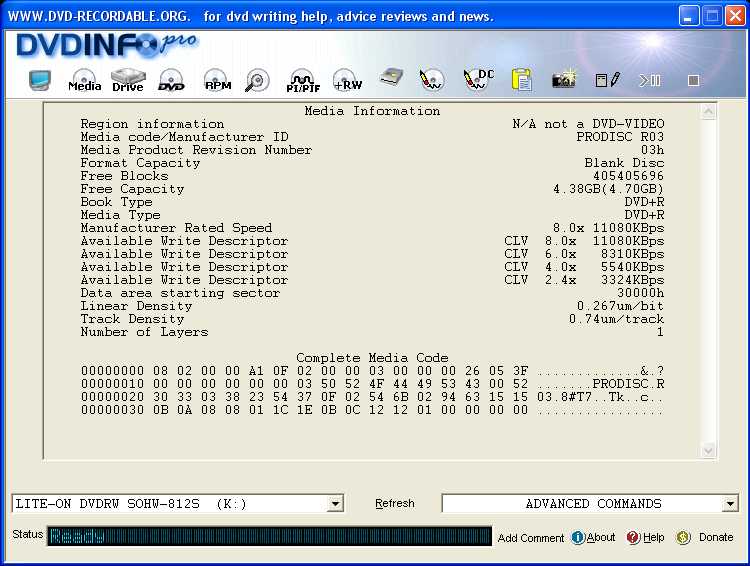

    I just got my Prodisc Hub Printable 8X dvd+r's From RIMA.com, here is the screen shot of the media code,
    LITE-ON DVDRW SOHW-812S US0Q (ATA)
    Current Profile: DVD+R
    Disc Information:
    Status: Empty
    Erasable: No
    Free Sectors: 2,295,104
    Free Space: 4,700,372,992 bytes
    Free Time: 510:03:29 (MM:SS:FF)
    Physical Format Information (ADIP):
    Disc ID: PRODISC-R03-03
    Book Type: DVD+R
    Part Version: 1
    Disc Size: 120mm
    Number of Layers: 1
    Last Physical Sector of Data Area: 2,491,711
    I JUST got them and they are a little cold but i will be burning one in a little bit.

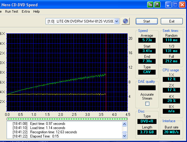

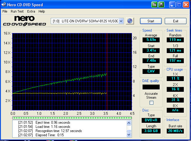

    Okay, here are a couple of scans of the Prodisc dvd+r hub printable
    The media codes are posted above.
    This is the first disc from a 50pack.
    All burnt at 6X
    This is the 4th from the same spindle
    Now the problem..... from disc 5 to disc 9 so far.... they have all been coasters, opened the second 50 pack.... same problem after disc 5 they all went to hell!!!!! I have not even burned this many coasters going through 100's of dvd's let alone in one 50 pack!!!!!!!!!!!!
    Very unhappy with these "+" disc's
    Gonna e-mail Rima to see what they will do on a return or exchange for some other's, only problem is i want "+" and i don't see any other hub printables there
    If you want i can post a scan of one of the coasters.
    9 coasters & 12 good disc's out of 21 & the all the coasters seem to have a problem near the end, like when i watch them they start to pixalize, stutter, freeze... but the videos are only around 3.72 - 4 gigs.
