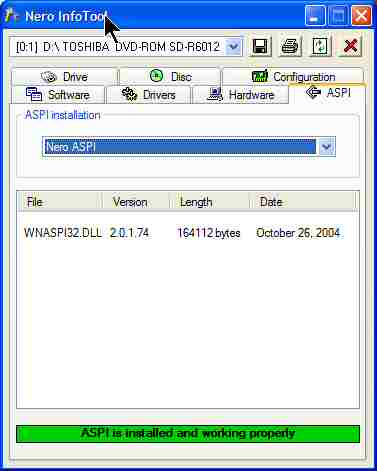

Nero uses it's own ASPI, you don't need to install the Adaptec one.
"Just another sheep boy, duck call, swan
song, idiot son of donkey kong - Julian Cope" -
If that's true how come it doesn't show up when you do an ASPI check?
Would I lie to you?
Perhaps it doesn't show up with ASPICHK because it isn't in the System directory, it's installed under C:\Program Files\Ahead\Nero (amongst other Nero subdirectories.)
Use Nero Infotool for proof (see screenshot below)
