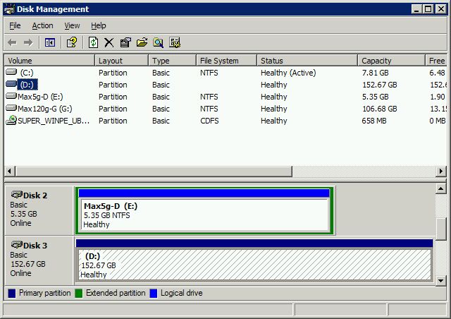

  1. So I am in the postion to reinstall W2K, formating a drive partitioned into C: ~8g and another partion - D: (rest of drive) - and the drive letter has changed from original, pre reinstall state where it was my F: drive).
    I ONLY formatted C: to reinstall W2K but the secondary partition (F: but now currently D: due to it be recognized but not really) is not available... When I click on it, it asks me to format - WHICH I do NOT want to do...
    My ? is... how best to rescue the files from this drive that is "not" recognized...

  5. Well downtrodden again.... Installed SP4 and still nothing.
    Here is a pic
    It's the D drive that I am trying to get back....
    Any help graciously appreciated!

  13. Well "Recover My Files" worked like a charm... all 140+gig recovered
    Life is good.....
