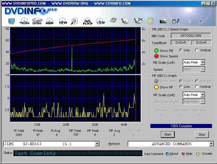

As much as it pains me to admit it :P , because I absolutely hate Optodisc and have had horrible experiences with their discs in the past, I bought some Velocity 8x +Rs and they turned out to be Optodiscs and they have been OK so far. Actually, PI/PO scans on them are quite good, burned at 8x on my NEC 2500 and Benq. Media code Optodisc OR8.
While I'm no fan of Optodisc, if these are the same media code, they may actually be decent discs.
Here's a scan of a disc at 8x on my NEC 2500, Benq burns look almost identical:
Same media code as mineOriginally Posted by steve2713

I should say though, that Matt seems to have -Rs, not +R discs, so I cannot speak for the quality of those discs. However, if my +R OR8 discs are any indication of the GQ ones that stiltman has, they're certainly worth the $1 per 25

here's my scan
