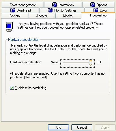

There is one Windows setting you might check. I'm not sure exactly where it is in Win2K but in WinXP it's Display Properties, Settings, Advanced, Troubleshoot, Hardware Accelleration. Make sure it's set to Full. There may also be a "Write Combining" check box -- make sure it's enabled. -

I checked the "Hardware Acceleration" setting and is set to full. I didn't find the "Write Combing" check box but I'll look for it. -

Not all video cards will have that setting. On my computer it's on the same page as the Acceleration setting:I checked the "Hardware Acceleration" setting and is set to full. I didn't find the "Write Combing" check box but I'll look for it.

Regarding the "Write combing" setting, I don't have it. -

Yes, I have the same jerky file on all these computers (3 different computers all having onboard sound).
Maybe there's something wrong with my PC, video card or drivers. Also I suspect an overlay issue. I must learn more about this.
