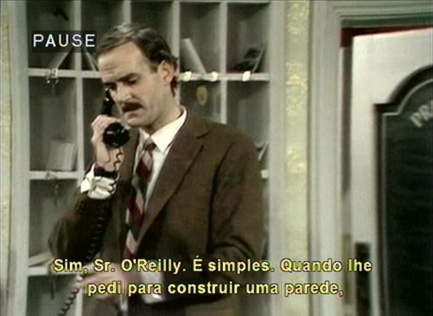

    Here is a capture of Bruno's yellow bold latin1

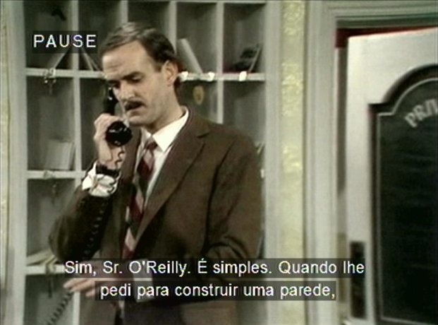

  7. And here is Bruno's yellow latin2 non-bold against a semi-transparent background

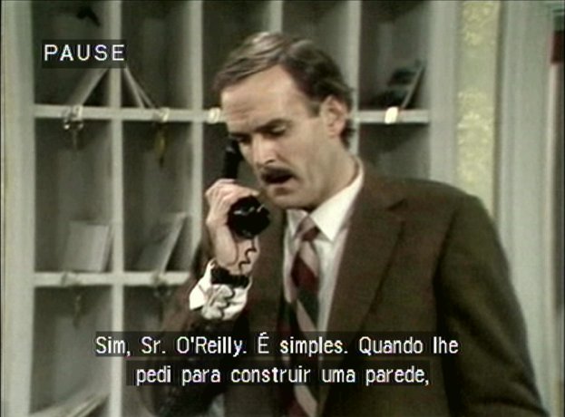

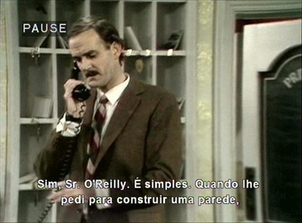

  10. Here are a couple of screenshots of HuffyK's 630/00 v2.1a - modified fw 0531.
    The first is the 28pt white outlined font
    HuffyK 630/00 v2.1a latin1

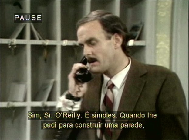

  11. And here is the same firmware with non-bold 28pt against a semi-transparent background.
    HuffyK 630/00 v2.1a latin2
