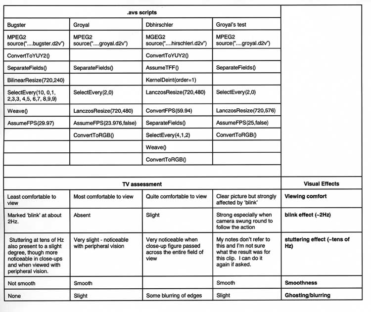

    Here is the final story in tabular form. Tough that I can't preview the jpeg as the print may be too small to be comfortably visible. However, I've saved it as a grey jpeg and you will hopefully be able to pick it off the screen and view in in a graphics application - it its not readable directly.
  3. I've got it. It really can't be trimmed without losing the essence of what it is. Send me your e-mail in a PM and I'll send you the FTP details.
