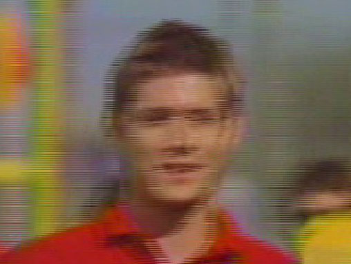

lordsmurf, I usually respect what you have to say, but I honestly don't understand where you are coming from with respect to resizing an interlaced frame.
How can you not understand that it will get fucked up if you resize it vertically? Have you ever paused on an interlaced source and watched your TV image? It shakes back and forth in two moments in time.
I am sure you know that interlaced frames contain two fields. Each field represents a different moment in time. Pausing on one frame shows both moments in time and the TV is properly displaying it when it shows that shaking image. It is actually displaying two alternating fields over and over.
Each field is on alternating lines. The TV displays each field one at a time. The fields cannot be shifted; they cannot be blended. Doing so would severely screw up your video.
How can you say otherwise? Just saying that you do it all the time is not good enough. I've done it before too and it was completely fucked up (and rightfully so).
