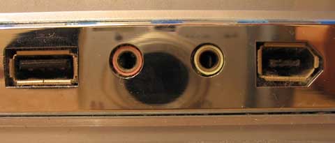

  5. USB on the left, FireWire on the right. Sorry about the state of my ports!
    You have to admit that they do look extremely similar to someone inexperienced with computers, especially if viewed from a funny angle.
    What I don't understand is how a USB plug was insterted into a FireWire socket when the rounding-off of one end should prevent it.
    Let's wait for an answer, and take it from there. There has been a mistake in the wording, methinks.
    Cobra

    They ARE the same !! Yes they are, black & plastic !
    Looks like you are confused with the 4 pin varity.
    USB powered & non powered
    Firewire (powered)
    Firewire (4 pin - not powered - typical video camera)
    The trying to connect a high speed USB device to a slow port message is because you are plugging a USB2 device into a USB1.1 port.
    Is the port on a 'header' or directly off the motherboard. I have seen machines with front USB ports only being 1.1 and not 2.0.

    Ok folks thanks that clears it up really.
    I've now had a look at the back of my PC and see a 1394 firewire port there (labeled) -yes this one is rounded at one end!
    When I bought my pc the companies web site said that it has one firewire port and one USB2 port routed to the front casing. It does have one USB2 port routed to the front but I guess the other port on the front is a USB1.1 port and I have been kind of ripped off - not knowing what a firewire port looked like I didn't know the difference til now.
    So that explains why I can connect a USB device to both ports - I can't understand why there is a USB 1.1 port on the machine let alone routed to the front.
    Oh well yet another thing I am unhappy with about my new pc.
    Regards
  8. Ahhhh - so you were told that it had a FireWire connection on the front and not knowing what it looked like, you mistook one of the ports for FireWire! I wish companies would give one sheet of paper with their PCs to tell the end-user what port does what...
    Glad you got it sussed, anyway. Will you be taking the PC back and asking them to sort it out? Make sure that it is actually meant to have USB2.0 and FireWire on the front panel, and that it isn't one of these optional extras.
