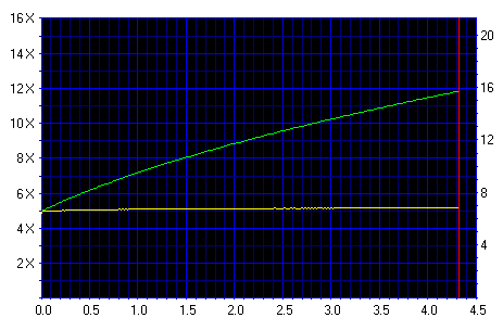

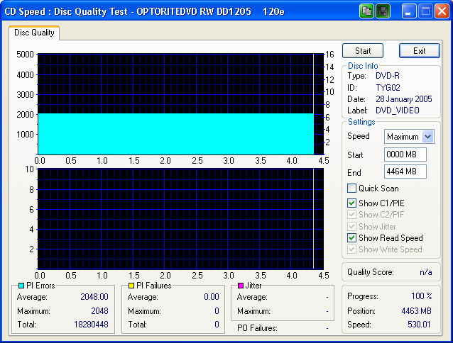

Ok, interesting little thing: When I use Nero CD-DVD Speed, the Disc Quality Test only shows PI Errors and not Jitter or PI Failures. Heres the results from the transfer rate test and that disc quality:
That is one weird scan. I have never seen PI to be level an near 2000. Something is wrong with the test. Your transfer looks fine. Don't know what else to try. Do your other disks look like this?
Yep, they all look like that, both the Prodiscs I have and the TYs. I'm new to all this, but I know that the scans arent right
Try the dvd in another player,sounds like your koss doesnt play burned dvds very well,as to the scan your dvd burner isnt supported for quality scan test so you will get weird test results.

With a transfer rate test like that, your player is probably to blame, as johns0 said.
