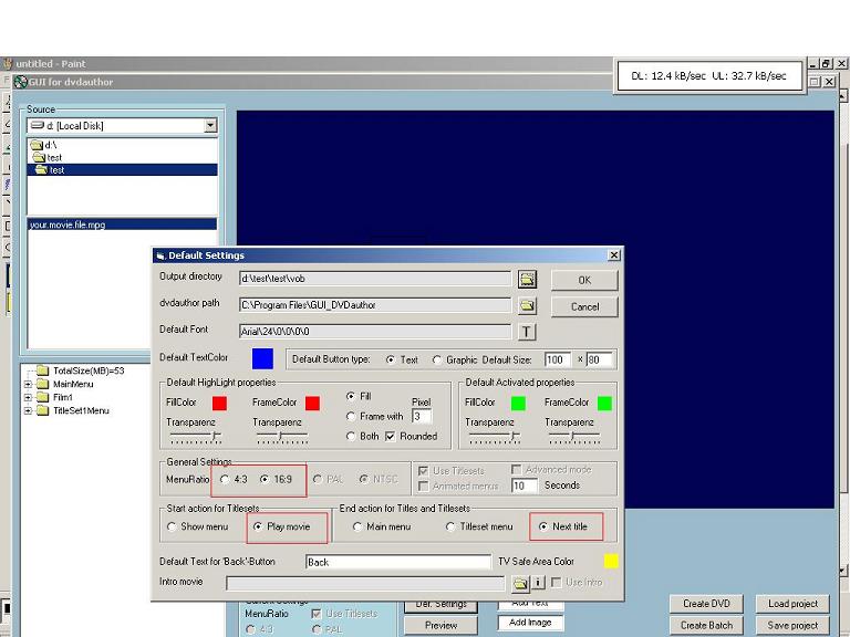

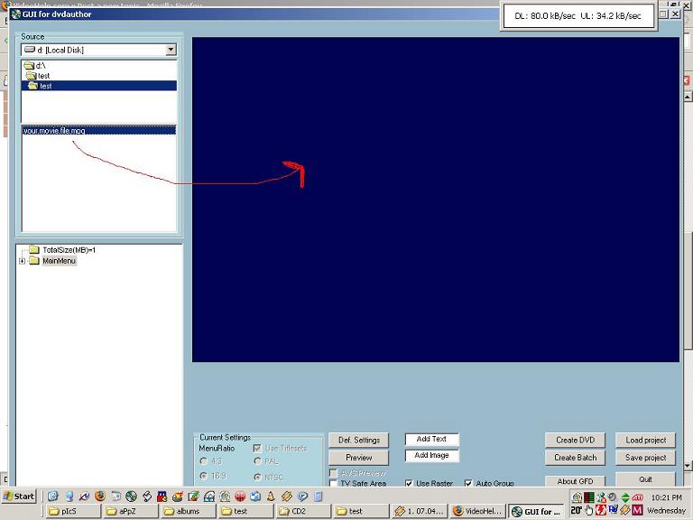

    1.) First open Gui for Dvdauthor.Then you need to hit the Def. Settings button. This is where you would define things like aspect ratio and such (I really hope I don't need to explain this). The important thing is you need to define the output directory. Make a separate folder like "vob" within your movie directory (GFD can do this for you) and set that as your output directory (the beta version lets you set a separate temp directory). In the picture below I have put a red rectangle around the items you need to set and what to set them to (you have to figure out if the aspect ratio is 4:3 or 16:9).

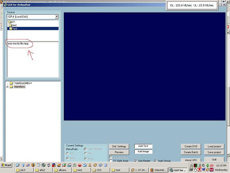

    2.) Navigate to your movie file. Make sure the file has no spaces. - This is important!!!!
    3.) Select this file and then drag it any where into the main window.

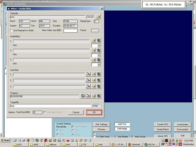

    4.) Once you do this, a dialog box will pop-up..........This is where you would add additional audio files, subtitles, etc. For now leave everything at its default and hit OK.
    If you have a second part of the movie just drag it over like you did the first one..........BUT YOU MUST DO THEM IN THE ORDER AT WHICH YOU WOULD LIKE THEM TO PLAY!!!
    5.) Now you will need to hit the Create Batch button. Basically what this will do is create a Mainbatch.bat file as well as other things you will need to author your dvd. Once the process is done (in about 15 seconds) close the program.

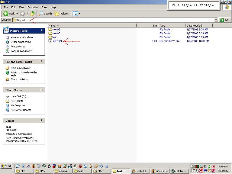

    6.) Now after your done creating batches for all of your movies you need to call them. This is where some knowledge on how to write batch files would be helpful but is not necessary. Create a batch file in any directory you would like and call it something like start.bat (I just right click and select new text file, select the text file, hit F2 and rename it what I want). THE EXTENSION MUST BE .bat
    7.) You you need to right click this file and hit edit. In all of the directories for your movies there resides a Mainbatch.bat file. You defined where this went when you set the output directory (remember step 1??). Basically what you are doing is editing the start.bat file so it will activate each mainbatch.bat file. Following me so far?..........Good! Let's continue......

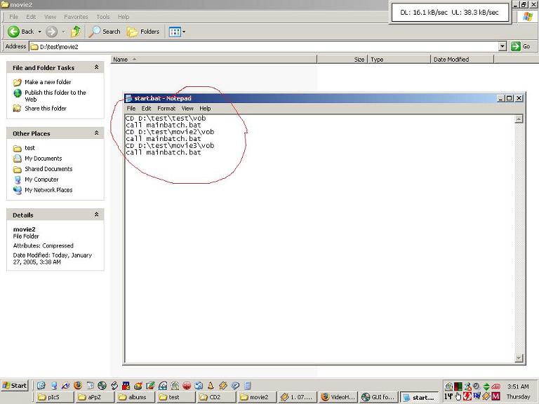

    8.) When you edit your batch file it needs to look like this..........
    Lets take a closer look line by line:
    1.) CD D:\test\test\vob - this is you telling windows where to find the mainbatch.bat file. THIS IS A MUST BECAUSE THE BATCH FILES DO NOT HAVE A FULL PATH. Or at least that's how it was explained to me.
    2.) Call mainbatch.bat - this is you activating the mainbatch.bat file (the actually authoring process).
    - And then you repeat for the next movie. Pay close attention to the picture I provided.
    NOTE: IF YOUR USING VERSION 0.83 OR NEWER, MAINBATCH.BAT WILL BE LOCATED IN THE TEMP DIRECTORY THAT WOULD BE SET IN "DEF. SETTINGS".
    The easiest way to do this is to navigate to where the mainbatch.bat file is and copy and paste from the address bar (see picture from step 6).
    Once you are done, save the .bat file and close notepad. To start batch authoring just double click the start.bat file and wait a few minutes (more like 10 - 15 minutes per movie) for it to finish. You will see a dos window pop-up during this.

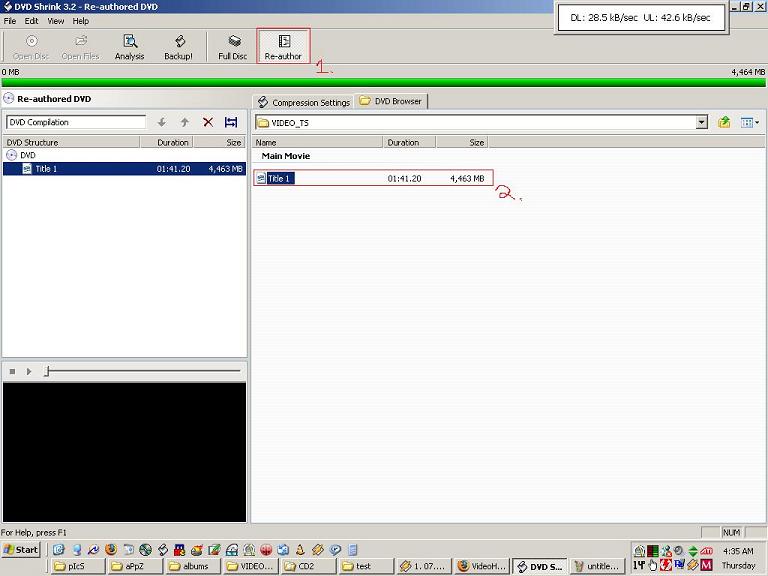

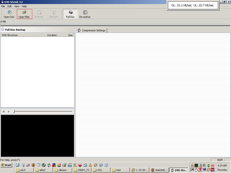

    1.) Open the program. Select "Open Files" and navigate to your first "vob" folder. And then Hit "OK". It will take a few seconds to analyze the tracks.
    2.) When it is done analyzing, select "Re-author". You then double-click ONLY the tracks in the order at which you would like them to play. Then select backup. Select the output folder (I would put the folder in the directory of the movie and call it "vob2". Then hit OK.
    I use dvdshrink because it is very fast and the quality is excellent.
    Note: If you would like to keep the menus, select "Full Disc" instead then hit backup.
    DvdShrink will be done in about 15 min. depending on your cpu speed. Repeat the DvdShrink steps for all your movies.
