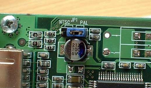

Sounds like NTSC/PAL signal crossover issues.

I'm with lordsmurf,it sounds like the jumper is set wrong make sure it's set to your standard(NTSC or PAL):
Also make sure you have TV enabled and adjust the color in ATI Control Panel. -
