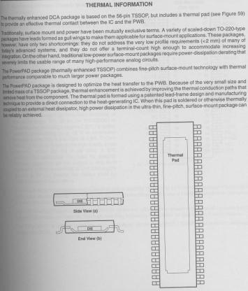

The temperature readings are much more reasonable now. Combined with the vent holes in the top cover, when I refit the cover it should be cooler.
I still have to investigate the digital can, ie. does the thermal pad contact the shiny metal.

I have now opened the digital can, and like yours, the thermal pad is not contacting the LSI chip. I might modify the limit stops on the can so that it can be made to contact.
Also regarding the SW-7V changing over the warm-up time, I see now that SW-29V changes also in approximately the same way. I will measure the drop across the resistor chain when I get the chance, as it could be that SW-29V is changing and the reason SW-7V changes is because the voltage drop across the resistors is constant. ie. it's not a problem. -
Are we sure that designers idea was to use metalic shield as a heatsink ? Maybe they put thermal pad to avoid in any case contacting metalic top of chip ?
Definitely. Large ASICS dissipate lots of power, and the metal slug visible on the LSI one tells me that this is a "warm" one!
Thermal pads are usually/always electrically non-conductive so I have no fears about making the thermal pad contact the ASIC.
I will check this one with my meter to make sure! -
Of caurse pad are non conductive thats why I make guess that it can be used to avoid electric contact and not to provide thermal contact.
Anybody can check if metal plate on top of chip is grounded ? -

It would serve no purpose for the designer to dimple the cover to bring it close to the DMN8652 then use a pad to prevent it from touching. You may not have seen this, but some IC's have the thermal pad built-in to the package. This has been done for many years.

The DMN8652 will be much happier with those temperatures. The good thermal contact insures that the IC will not be too much warmer than the can temperature. Let's hope it solves mig-45's green lines too.
