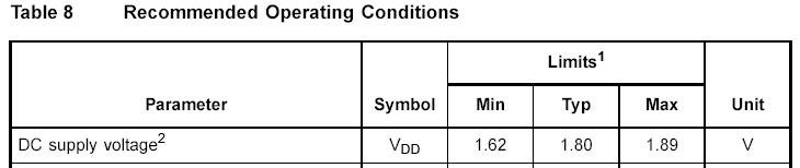

The only unusual findings have been that the +1.8V to the LSI processor has been set at +2.05V which has a spec. of +1.8V and that the AL5.3V has been set high as well, to +5.75V which puts it very close to the maximum rating for C7202 and C7203 on the system processor board. Other parts run hot but they should not be failing at room temperature.
I suspect the "Loading" problem is related to AL5.3V. This voltage is determined by three resistors and one IC. The other +5V power in the M10 is labelled SW5V. SW5V has its output voltage determined by only one part, a zener diode. AL5.3V only supplies the system controller which is probably the source of the "Loading" message. I hope this is the answer because the repair cost is pennies.
AL5.3V and the +1.8V to the LSI processor are the only voltages in the M10 that are determined by resistors. -
Here is information regarding LSI's recommended operating voltage for a +1.8V core device.

Only AL5.3V has something in common with all these comments. It provides a +5.75VDC to two capacitors rated at only +6.3VDC located in the system controller. The value of AL5.3V is set by resistors. AL5.3V rises to its maximum voltage in "power save mode". -
Ah I see now what all those resistor issues was related to! Now its clear why you tracking AL5.3V. But regarding loading problem I also read that there is ROM update took place in some cases. I will wait if green lines appers to unsoldering can and also will try to add heatsink to DMN - then I also will be able to get more information about JCP and 1.8 voltage.
We already know that +2.05V is too much for the DMN-8652. It is possible it is too much for the JCP8059 too. There are not too many modern IC's that operate on +2V. Most are +3.3, +2.5, +1.8, or +1.2V.
I was thinking if there could be a reason for why they do this. One possibility is that they are trying to share power dissipation with those IC's. The PQ5EV3 gets less hot if the output voltage is raised but the JCP8059 and DMN-8652 will get more hot. D5308, D5309, D5310 are used to lower the input voltage to PQ5EV3. This helps the PQ5EV3 get less hot but the diodes get hot.
I will wait and see if you have more information on the JCP8059 later, but I suspect this D1.8V is the bad guy in your M10. -
Probably you right. But what seems strange to me that as we found 2v are normal with resistors using with PQ5EV3 - so designers had in mind that there will be exactly 2v not 1.8 shown in manual! I mean that if it is the reason then all ppl who bought M10 should have this problem if not fromt he begining then later. I only hope that this fact didn`t damage any of those huge chips!
Every IC is different. The manufacturer has a specification so that essentially all the product will work inside the specification. Outside the specification, some will have a problem but not all. Do you notice that the DMN-8652 can work successfully if the voltage is 0.18V low but it will have a problem with only 0.09V high.
I am thinking that even if the JSP8059 is designed to use +2V, it will still be safe to operate with .11V low. If this is true, the DMN-8652 will be at +1.89V which LSI says is safe and quaranteed.
I think the 8652 is an important part and it is not a good idea to operate it outside of the manufacturers recommended region. -
