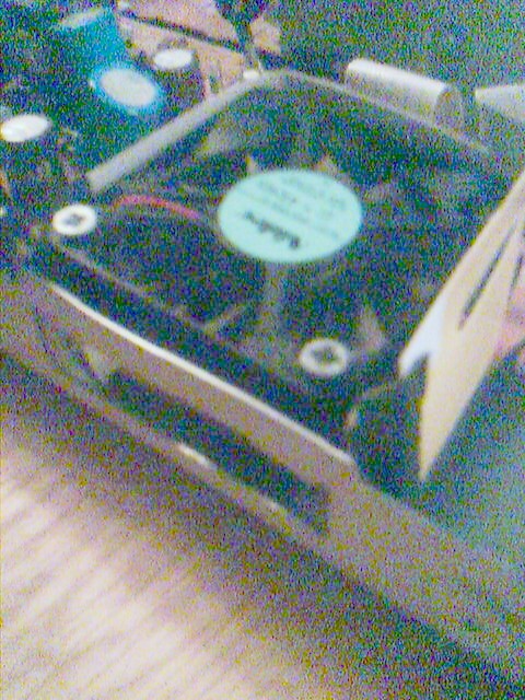

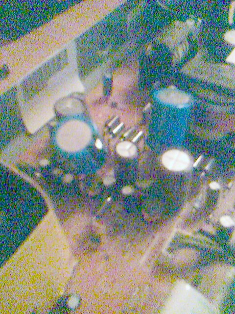

It lives!!!
My new long-life caps are doing the trick (see the new light-blue caps mounted at an angle). The 2nd fan (mounted on the handy lugs already provided as seen in the attached pics) is keeping the power supply nice and cool. The card ducting (weetabix carton) ensures air is drawn in through the side vent and upwards towards the lid. I've left some card at the front of the ducting to help direct the air towards the rear - over the top of the caps in the PSU.
The 12v fan is powered by an external power pack. Running at 6v, it remains effective with almost silent running.
In operation, or in power-save, the lid over the PSU now is cool to the touch, unlike before. All this, and I didn't even have to hack about with the chassis.
Thanks, once again, to all who have contributed to the diagnosis & repair advice for this annoying problem.
