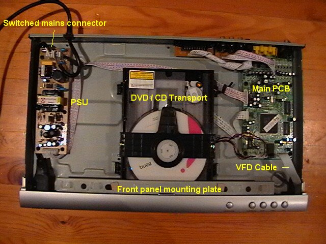

Remove the cover:

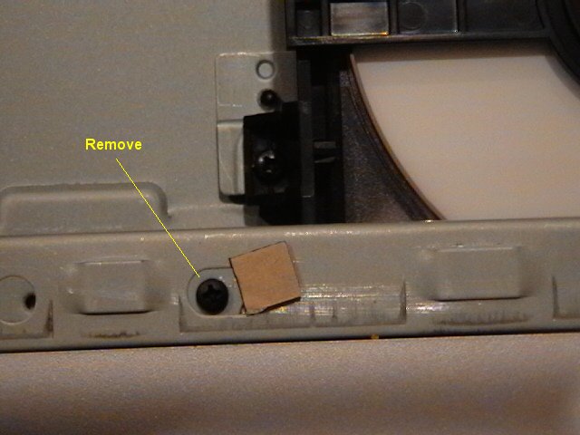

1) Remove 2 pairs of shiny screws on either side of player. Remove two shiny screws on left & right sides
of the player at the rear.

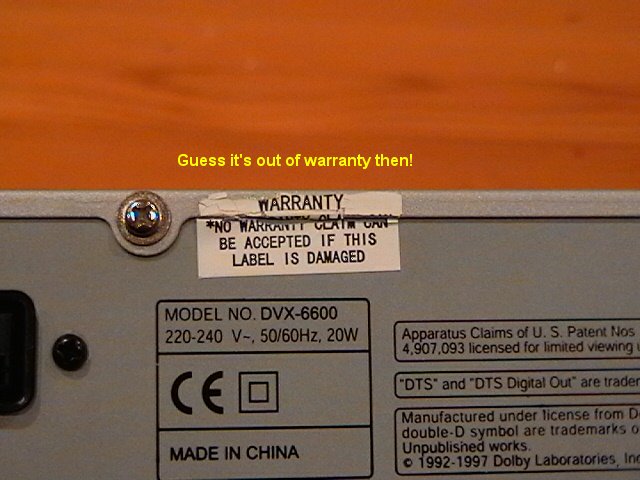

2) Try this: Use a lighter & heat up warranty seal & try to prise it off the cover using a scalpel blade
(informed of this trick after taking my player apart L ).
3) Remove final central shiny screw at rear of unit.
4) Remove cover by lifting up at rear of unit & then sliding tab out from under front panel.
Remove the front panel:
1) Disconnect VFD cable - just pull it out the connector. Remove mains switch cable (black cable running
down left hand side of unit, inside of which is a black and a white cable) by squeezing the connector &
pulling it out.

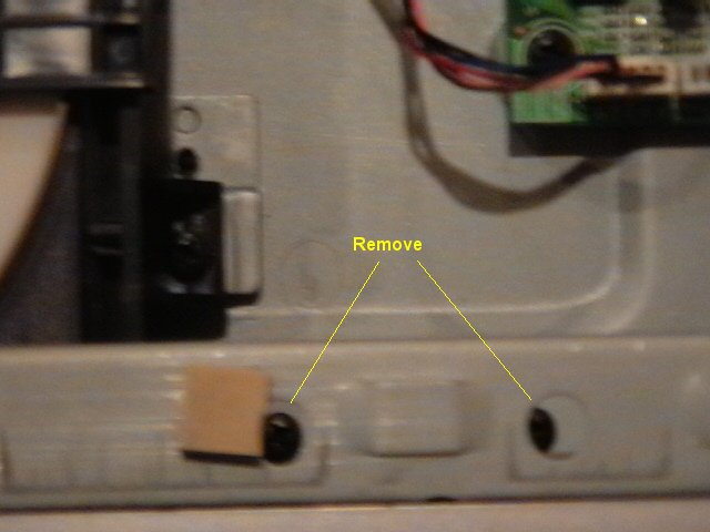

2) Turn unit upside-down & remove 3 black screws. Remove 2 black counter sunk screws on either side of the
front panel (next to the front panel retainer clips).
3) Turn unit right way up again & remove 3 black screws either side of DVD.
/CD transport on mounting bracket. Note how short they are.

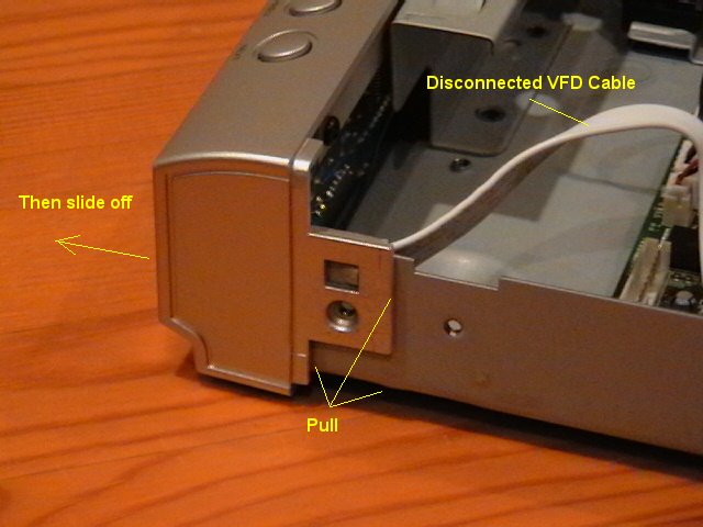

4) Slide off front panel, right-hand side first by gently pulling the catch over the formed bump in the
chassis. Repeat for the left-hand side. Slide entire unit off.

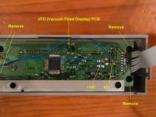

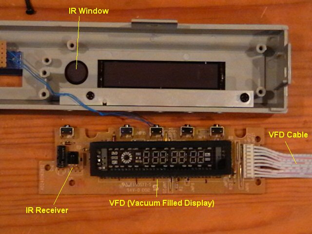

Reposition IR receiver. (Completely ignore this step if you wish).
Might as well do this now that the player is apart!...
1) Remove 4 black screws on PCB. Lift out, top end first, the VFD PCB.
The picture below shows 2 blue wires connected to +5V and GND on the VFD PCB – ignore this for now, this is
part of the mod explained later.
2) On my player the IR receiver pins had not been cut short once soldered onto the VFD PCB so I resoldered
this component maximising on the extra length of these leads.
3) Using some nounce & a pair of pliers to reposition IR receiver closer to its window. It did make a
noticeable difference when using the remote on my player!
I have seen suggestions on the Internet that further improvements to IR reception can be made if the shiny
coating on the window is scratched off! By all means take this opportunity to totally ruin the looks of
your player & scratch away but this is totally unnecessary. I have found that the limiting factor with
regards reception is now purely down to the remote control & not the player. I purchased a
OneForAll remote control & I can ‘hide’ it behind my hand & it still works.
4) Once done, put VFD PCB back in place & screw in 4 black screws removed.

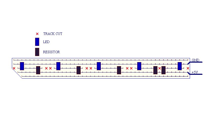

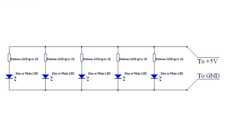

Making an LED Illumination Board.
Circuit Diagram.
The picture below shows a circuit diagram or schematic of the LED board that will be constructed on the
strip board:
The resistor values can be anything from 220 ohms to 1K ohms – the lower the value the brighter the light
emitted from the LEDs. I chose for my mod 330 ohms. You can use SMT (surface mount) or THP (Through Hole
Plated) parts for the resistors and LEDs it does not make a difference. I used SMT as they were easier to
assemble.

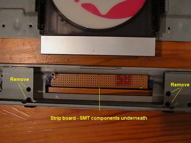

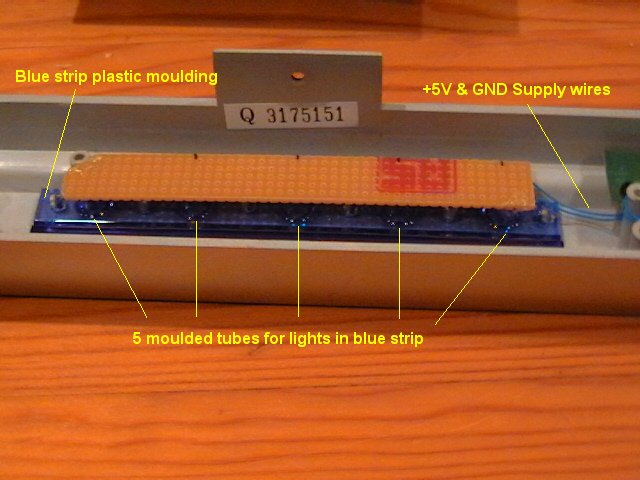

Strip Board
Picture below shows copper-side up of strip board & how I’ve mounted some surface mount LEDs and Resistors:
Notice the notch cut in the corner to avoid interference with a mounting pillar on the front display panel.
The LEDs are placed in such a manner so as to align to the centre of the tubes in the illumination strip
and the resistors are mounted in such a manner so as to not interfere with these tubes. It should then be
possible to mount the strip board flat to the surface of the tubes.
I have shown surface mounted components but the same layout can be used for throughhole (leaded) components.
Note: LEDs do have polarity – if one doesn’t light up in one orientation then simply desolder it and turn
it around. Connecting & applying power to an incorrectly or reverse connected LED won’t damage it.
Mounting the LED Board
I mounted the LED board to the front panel illumination strip by first making sure the LEDs seated inside
the holes and then gluing the board down using a hot melt gun making sure that the edge of the board was
clear of the DVD / CD loading tray hole by at least a couple of millimetres.
Connecting The Supply Leads
Once the board has been tested and is glued in place, solder the supply leads to +5V and GND on the VFD
PCB as shown in the picture below. Don’t worry if you accidentally get them swapped, as no damage will
occur. (Ignore the ‘Remove’ text).
Looking at the connections on the right of the VFD PCB that the VFD cable is soldered to, counting down
with pin 1 at the top:
1 - ignore
2 - ignore
3 - ignore
4 - GND
5 - +5V
6 - ignore
7 - ignore
8 - ignore
9 - ignore

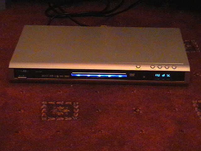

You can now sit back and bask in Blue LED Glory.
Good Luck & Happy Modding,
Andy.
Notes
Lights: For this project I used 5 SMT (Surface Mount) blue LEDs that have the effect of making points of
light as you can see if you look at the first picture at the start of this guide. I was hoping for a more
‘consistent’ lighting effect. Because the blue plastic strip is effectively a wave-guide, I could’ve placed
bits of cardboard in the 5 tubes directly in front of the LEDs to prevent this undesirable effect. Some of
you may like this – it does at least look like the promotional pictures of the player I have seen on the
‘net.
As far as I can tell the player was never intended to be shipped with the blue strip illuminated. This is a
cheap player and Blue LEDs are EXPENSIVE!
You’ll note that the LEDs will remain illuminated when the player is put into standby via the remote control
- this is not very professional and I have not found a simple way around this problem yet. However…
