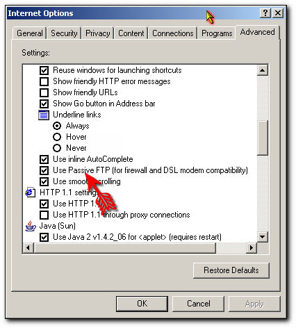

It does. Make sure that you are using PASV ftp as it may be an issue with your firewall/router... If you are using Internet Explorer:

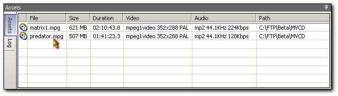

I think it is the other way around... No matter. It works now:Originally Posted by freak
Pred has a RIFF header. Prior to RC1 these would not import into SVCD2DVD..... In RC1/2 they do.
I have made a small omission too in the code but after the RIFF2MPG bit has completed reload pred.mpg and it should work. The original is renamed to xxx-ORIG.mpg. The asset reload should be automatic but like i said i missed that bit!
Let me know therefore if you have sucess with RC2SVCD2DVD v2.5, AVI/MPEG/HDTV/AviSynth/h264->DVD, PAL->NTSC conversion.
to make an DVD image of the moviez is no problem...
my problem is, that matrix doesnt work on an standalone dvd player and predator does. -
ok. I will try on my standalone.
Well my suspicions were correct about the GOP length. Matrix has an average GOP length of 80+.
It should be 15 maximum for PAL mpegs in order to be DVD compatible.
Pred has an average GOP length of around 20 which again is too high but many DVD players are forgiving to some degree…..
Your options are to re-encode the mpgs to have a DVD compliant Max GOP length.
Sorry about that.
Is such a high GOP length part of the mvcd "spec"?SVCD2DVD v2.5, AVI/MPEG/HDTV/AviSynth/h264->DVD, PAL->NTSC conversion.
