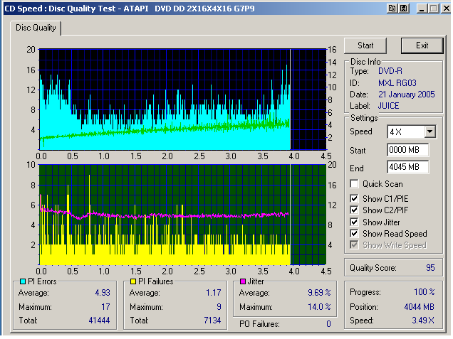

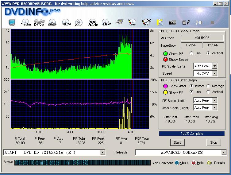

    Hi guys. Here's my first-ever scan on a disc, which I burned w/ my rebadged BenQ 1620.
    Any comments?
    THX,
    MJ
    Not great. Burned too fast? Burner firmware? Two problems to consider here.
  3. It looks ok until those spikes in the last 500mb of PO errors. Those are strange spikes though, to have PI maxing out around 30 while the PO(PIF) maxes past 200 at the same spot on the disc is really odd, typically PI numbers will be alot higher than the corresponding PO numbers at a given spot on the disc, and just the opposite is happening near the edge of your test here.
    Do a scan using Nero CD-DVD Speed and post that, I've sometimes had DVDInfoPro have wacky tests.

    Okay. I did a quality test; the scan is below.
    I looked over the limks you sent me, Budz, and tried two of the methods -- uninstalling Sec. IDE Channel & IDE Controller -- but that did not change anything, unfortunately: my burner is still in DMA Multi-Word, and the other 3 drives are still PIO.
    I'll look into mobo BIOS and the registry tomorrow.
    - MJ
  12. That's a much more reasonable scan, and that shows why I don't use DVDInfoPro for testing discs - it seems VERY unpredictable and inaccurate. Good luck with your IDE controller(s).

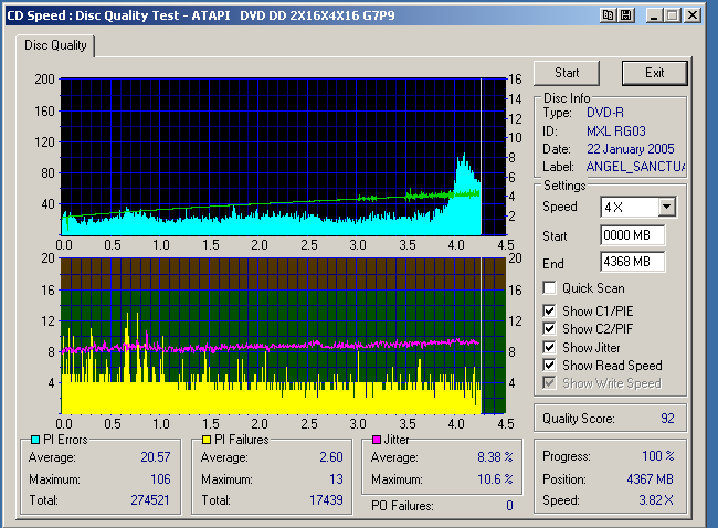

    Hi guys. I DL'd ASPI 4.71, and I guess I'll install it now. I ran the check util, and it said ASPI not correctly installed -- could it be b/c I use a "modified" version of Win XP Pro -- so I'll install it and see if that has any effect.
    BTW, below is my Nero CD Speed Scan for the 4.26 GB disc that I mentioned earlier. It scanned faster than the first one! ^_^

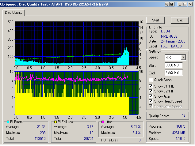

    Here's another scan....
    - MJ

  23. Not a great scan, but the disc should play fine.
