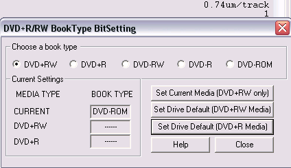

    My drive is a Benq 1620 - the only utility I have for setting book type is their own utility, and it does not allow setting a DVD+R to DVD-R...

  9. I'm sure DVD Info Pro would allow to set it to "DVD-R".
    I may be a total Maroon here but.... i don't see any option on DVD Info Pro
    to change dvd+ to dvd-, never even heard of such a thing
  12. Its the booktype, my friend that we can change...

    Does your drive allow for booktype change? Not all do.
    Ummm... yes!!!! i have been setting the booktype on dvd+ to dvd-rom for a looong time now..... but i don't see that setting on the official lite-on bitsetting tool or my version of dvdinfo pro, which i have the registered one.. althought it is V3.21
    or dvdrw_omnipatcher which is what i used recently to reflash my drive.
