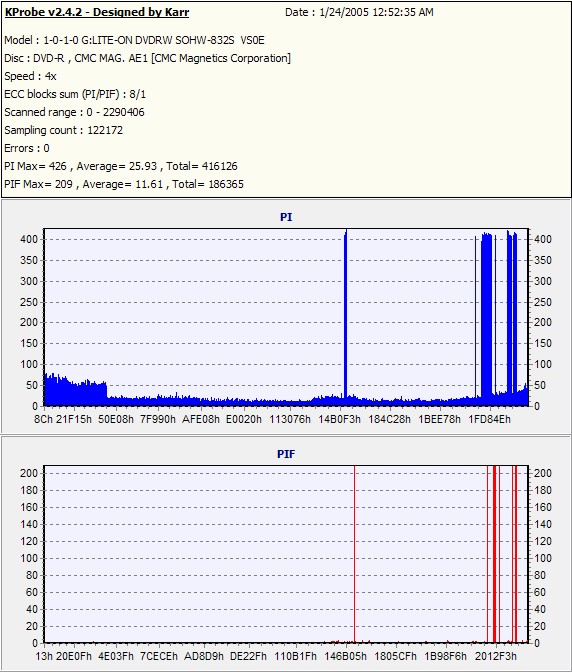

Clearly his Liteon will not be able to read those spots on the disc without reporting errors on a Scandisc with PO errors that high, I didn't need you to tell me that. It does look like he got a bad spindle, short of the very small chance that his Liteon is giving inaccurate scans of these discs. I did have issues with my Liteon 163 giving completely bogus scans of +R media burned on my NEC 2500 while it flawlessly scanned any other discs from other drives as well as -R media from the 2500, so the possibility does exist that is having issues reading the discs not related to the burn quality. My Liteon has serious issues reading +R discs from my NEC 2500, regardless of the media.
The main reason for even mentioning this is I've done at least 500 PI/PO scans, using two different drives, and I've NEVER seen abrupt spikes like that, only VERY narrow ones that are typically from specks of dust, that sort of thing. If you're familiar with PI/PO testing and have done a large number of scans, you'd know how unusual it is to have a wide spike (wide as in several 1000 PO errors wide, not a few errors wide) going from nothing to 200 and straight back down again. I've never seen it before, ever, and his whole spindle is showing it.
I'm not saying I don't think the discs are bad, the scans are just very unusual if the scans are accurate. A simple answer would be to do a transfer rate and scandisc on another drive (his NEC), if they show similar results obviously the scans are accurate.

. That's very interesting, any disc with a large block of PO errors up around 200 shouldn't even be readable whatsoever in my experience and everything I've read as well, and your transfer rate test shows that it only had a minor slowdown, down to 8x, which would probably not be any issue at all for a dvd player to play smoothly, and obviously all data would be easily extracted from the disc.
I'm finding this confusing, maybe your Liteon drive does in fact just not like these discs :P
Perhaps, Perhaps. Then again - I've noticed discs that slow any amount drastically like that big dip, often times have skips or at least pauses on standalones.
Of note though, Steve, is that if you look, when KProbing, the total error count is very low...1, 6, and the first one, even, has 0 errors shown. So my Liteon is displaying that the disc is 100% readable on the first one.. Just with large spikes.

Here is the KProbe scan. This was burned at 12x on my NEC.
Once again steve, the Liteon is showing no errors, just huge spikes.

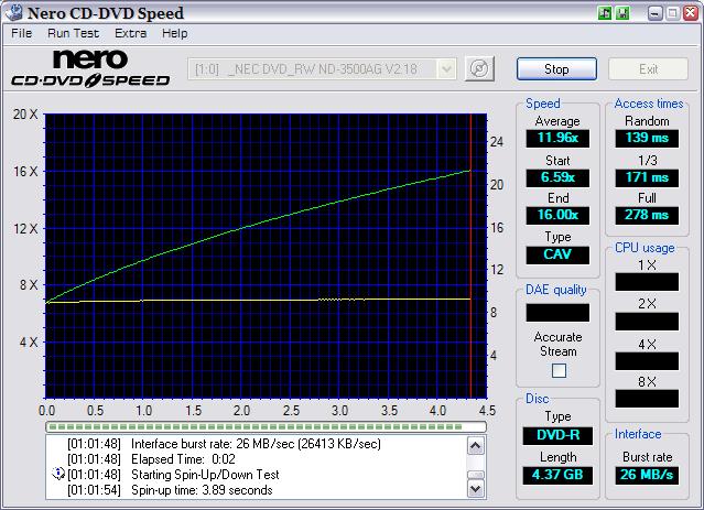

Here is the rate transfer of the one burned @ 12x.
(on my NEC)

I'd just be curious to see how the transfer rate test looks on the NEC, to see how well it can read a disc that is giving the Liteon errors with for comparison.
edit: I've got to admit, with your NEC showing a flawless transfer rate test of a disc that your Liteon is showing so many large spots of PO errors, I don't think that your Liteon scans can be trusted to guage the quality of these burns. A transfer rate test can be more telling than even a PI/PO test. Obviously the ultimate test for DVD video viewing is to play the disc on several standalone players, but in terms of ability to extract the data, the NEC is reading the disc flawlessly. -

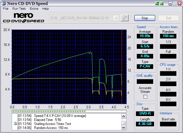

Steve - here is the scan on my NEC of the disc burned at 4x you requested.

Hmm, although it is not a very good transfer rate test and could cause skipping problems, I find it interesting that the slowdowns in read speed do not correspond with the large spikes on the PI/PO test of the disc. They do however look like they are slowdowns that correspond directly with the gradual rise of the PI errors near the end of the disc, ignoring the spikes and just looking at the unspiked parts of the PI/PO scan.
