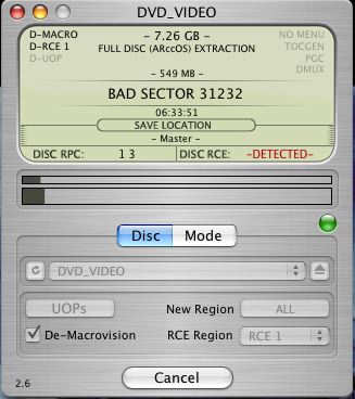

Off hand, did the screen look something like this:
This is what I was telling WW last night, and I gave up
on it after 90mins running!
this morning,
I tried to do a title only rip ( Arccos) and started it at 7 am CST
and it STILL didn't complete when I got home 20 mins ago!
At least hearing one person got it made gives me hope!
I'll start this tonight, and let it run an see what happens. -

You're welcome. Yes the MTR screen was the same as your screen shot. Though not sure about the "bad sector" note in MTR. Honestly, I had let it run and when I came back it had completed but had the "Bad Sectors" warning screen/window. The resulting DVD folder had the name""_ARccOS also. My rip did take longer but as I recall only about 2 hours??? I'm on Dual G4 800 with 1.25g ram, running 10.3.5. Not sure why yours is taking so long.
Again, I took this folder and ran it thru DTOX, movie only, and using the "Cells" tab, deselected the cells with no info(either no duration or no MB). I assume these are the dummy VOB's that are part of the ARccOs protection scheme(?) The resulting Video_TS folder played fine, burned fine.
Good luck -

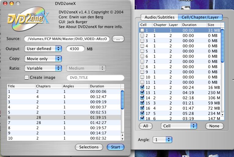

ronin,
ok after 51m, 52sec, it finally spit out a folder
from MTR 2.6. Ok, I got this in DTOX now, and
this is what I'm seeing:
Now, my only question is that I'm assuming you are talking track 6,
but track 7 also has those questionable "first eleven cells"...
which should I do? Does it matter?
( i am currently running it through DTOX as we speak, with
track 6 being the one I chose to deselect the first eleven from...
It's done)
Testing through DVD Player, it starts like you said, no skips
and credits are going by fine. This works for me.
Thanks, Ronin!

ok, figuring this out...
Track 6 is the THEATRICAL WS version of the film.
Track7 is the WS version of the film with Alt Ending.
no FS exists on this disc, and there are no extras.
ran the MTR output through DTOX, first doing track 6,
then going back and doing track 7. Plan on running
both VIDEO_TS folders through DTOX's join feature
to make a decent( minus menus and trailers)
backup. Will post back if I have problems."Everyone has to learn, so that they can one day teach."
When I'm not here, Where can I be found?
Urban Mac User -
