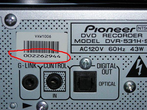

    Hi,
    I have a Pioneer DVR-433H, but I can't understand which is my 9 digits CPRM ID N.
    At Right of Fan there isn't nothing, no number and under the Tuner I view a bar code with 9 digits called MFD.
    Uder it there's only the 13 digits Serial Number.
    Please Help me!

  4. On all Pioneers it is a very small white label about the size of your fingertip, located next to the AC power socket on the back of the unit. The top of the label shows a combination of letters and numbers, ignore this. Below it is the bar code, and right under the bar code is the nine digit CPRM number you need. Sometimes you have to examine very closely because it tends to look like more than nine digits, its a trick of the eye: when you write them down it is always nine digits. Of course its possible the label for your machine was removed or fell off on its own, but if you don't have the label at all do not worry: the recorder stores it internally and will display it for you once you begin the procedure with the service remote. When you press ESCAPE and STEREO to get into service mode, the recorder will automatically show its nine digit CPRM number on your TV: just write it down BEFORE you continue pressing any other buttons.
    Jun 2008
    Italy
    trhouse, Thank you, now I understand...then maybe it gone lost because I see the four signs that mark the corners of rectangle (printed on the plate), but there is no paper.
