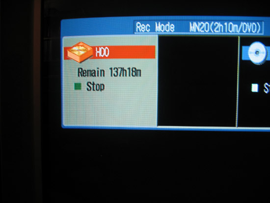

  9. I successfully installed 160GB hard drive into 510 recorder, today changed into 300GB, works perfectly! In SP mode shows about 128 hrs of space left.

    Simply changing hard drive is not enough, you need service remote GGF1381 or older one GGF1067, DATA ID disk and service manual. My first hard drive was Maxtor 160GB 5400rpm , then I changed to Maxtor Quick View 300GB(a little bit noisier than original, maybe size?), since original is 80GB Quick View(See Maxtor website, they’re designed for video recorders). But I think any HD works. In the service manual original HD models are: Maxtor model# 4R080L0- , Western Digital model# WD800LB- and Seagate model# ST38001~ACE.
    Procedure is simple, you change HD, with service remote delete the CPRM ID #, then input ID , insert Data Disc, power down, power on, initialize HD.
  15. [img]https://www.videohelp.com/forum/images/guides/p1197750/IMG_1095a.jpg[img]https://www.videohelp.com/forum/images/guides/p1197750/
