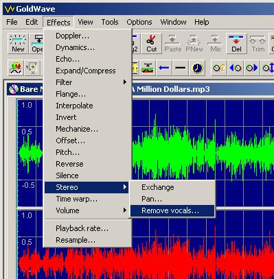

GoldWave has a filter to remove vocals (all it's doing is cancelling out the stereo channels against each other as other people have described.)
Sometimes it works okay, sometimes it doesn't really work at all (depending largely on the way the track has been mixed I think, as others have said).
You end up with a mono track (albeit with the same track copied to L & R so it's still a stereo file).
As someone else said too - it doesn't work well with mp3's - it creates a lot of phasing/flanging type noise. You'd have to do it on a raw wav to give it a decent chance of working.
Might be worth a try...
