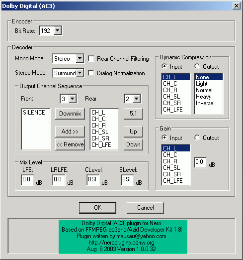

  13. I think in TMPGEnc if you select the DVD template you will NOT get the "3:2 pulldown when playback".
    So you may have to go as - new project > load your files > Select stream type as MPEG-2 and the only you will get the pulldown option under "Encode Mode"
    Even Nero AC3 engine is based on ffmpeg !!
