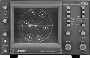

Get the real stuff Rosco Paint. There has been years of research getting the optimal tight point on the Vectorscope
For DV format, use Green because of the 4:1:1 sampling. Full resolution Y is mostly green.

You can goto your local paint store and get some color samples. Flat green around "arugula" seems to be the most usable color. Then use these to try and see which one keys best with your camera. Then you can find a green fabric to match your camera the best.
The pro chroma key paint is specially made for
Luminance = 57 IRE
NTSC phase = 242 degrees
and when properly lit, forms a tight dot on the vectorscope for separation.
