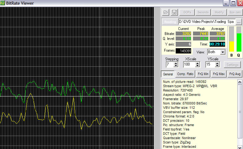

kabanero, do you have any information regarding the bite rate at each quality level for the JVC DR-M10S? And is it VBR? Also have you done any comparisons to say a CCE encode. I don't expect it to be better but even close would be acceptable for my needs.

M10S uses full D1 resolution of 720x480 up to 2 hours 30 minutes in FR mode. Then it changes it to half D1 of 352x480. And at some point around 4 hours mode and longer it uses 352x240 frame size. And yes, it is VBR. Here is the picture of Bitrate Viewer of the vedio that I recorded with M10S in SP mode:
Originally Posted by Jsteehl
Regards.
