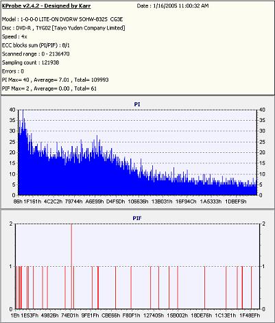

My friend burned this one with a Pioneer 105:

OK, thanks, what is that graph? What does it represent. Should I use that to check for quality?
