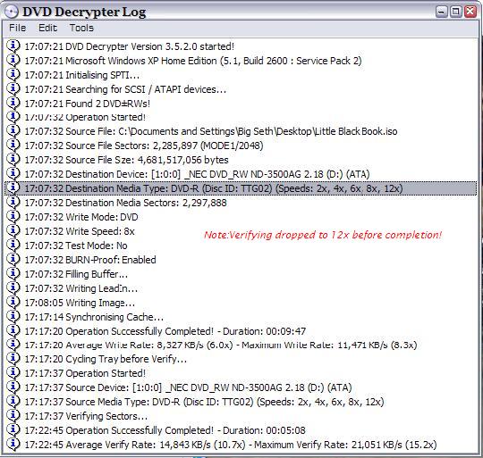

DVD Decrypter Burn Log Burned @ 8x

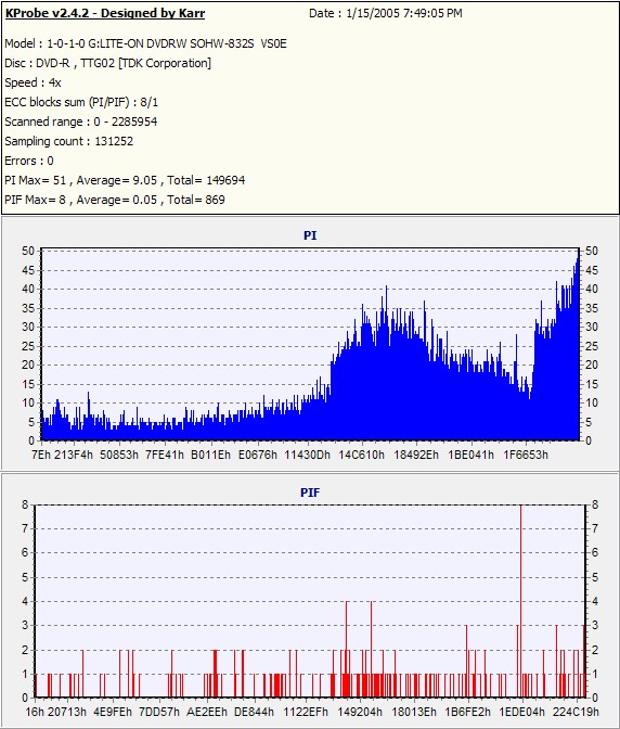

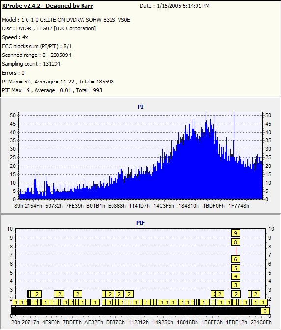

Kprobe - Burned @ 8x.

Here's the graph labeled for anyone that cares about the spike above 4.

look at your decrptor log and where you were burning the iso fromOriginally Posted by Fandim
time to change your XP profile name

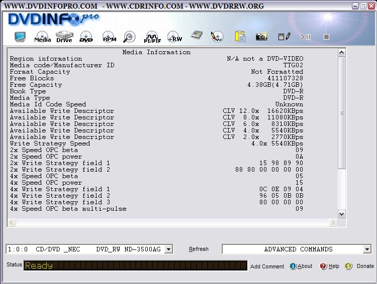

DVDInfo @ 8x

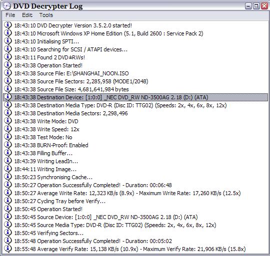

Decrypter @ 12x

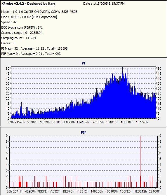

KProbe @ 12x

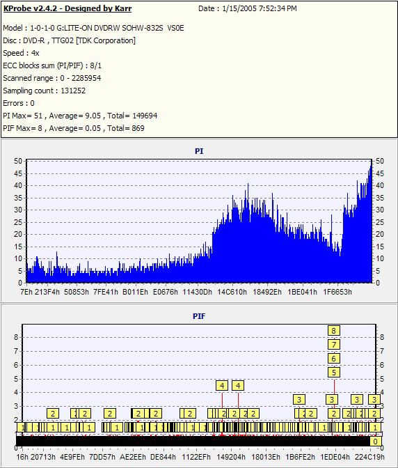

KProbe - burned @ 12x - spikes labeled.
So my firmware can't see the 12x's Descritpor? or is that desriptor sort of created by the firmware?
I don't know where the descriptors actually are.
I know how to view them with DVD info pro an DVD Decrypter but I don't actually understand where they come from. -
Doplletwo...consider firmware kind of like an internal driver saved onto the hardware of your DVD-Writer. This tells your writer, based on the media ID, how to write the disc, and how fast is permitted to write on that certain media ID code. (amont other things).
You can update your firmware, or get 'hacked' firmware, that will tell your write that it is okay to write at a higher speed that is normally aloud to a specific media ID code.
Writing at a higher speed than the disc is rated for, however, can be like instantly, and assuredly, creating a coaster for some discs. However, high-quality discs, like TDK, Taiyo Yuden, etc, can easily handle being written at above their rated speeds in most cases. (I.E. I burn Taiyo Yuden +R 8x DVD's, at 16x successfully).

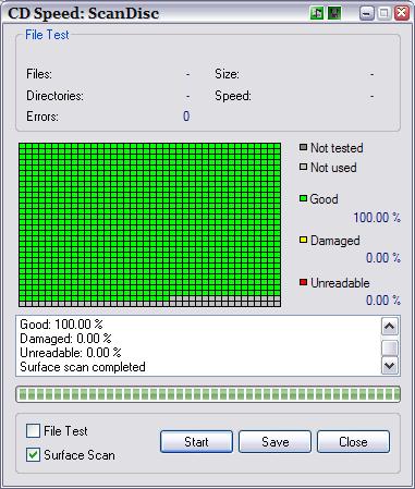

CD-DVD Speed Surface Scan (burned @ 12x)

I understand what firmware is I am being a chicken about changing it though. I think I will at least to remove rip lock but first I will try it on an old drive.
SO you are saying that the write descriptors aren't actually on the disc but generated by the firmare when it reads the Media ID code. -
Correct.
Flashing firmware is pretty simple, and not really as dangerous as it used to be, especially on the newer drives...
However, if you've never done it before...should always use discretion.
By the way - the reason you were able to burn your fake taiyo yuden at 12x, is because your drive recognizes that taiyo yuden is a high quality disc, and is able to be burned at 12x with no problems.
Therein lies the problem with fake media, by using TY's media ID code, your drive assumes it is REAL TY media..and it's easy to coaster generic brand-thief type discs burning them like they were actually TY. Some of the fakes can handle it, though. But most cannot.
