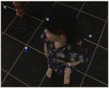

    Bad news I'm afraid pmcollins... As you suspected - All OK on my machine. Details for the benefit of others:
    1. DV AVI type 1 file captured on your machine. Played back on mine at "double speed", as it does on your PC, and with macroblocks (large pixelation), as it does on yours. See screen print:
    2. Used WinDV to view playback from your cam on my machine - no "capture". All OK, as is on your machine.
    3. "Captured" from your DV cam as DV AVI type 2 using WinDV. Started cam running then hit "Capture" - playback during capture is OK (whereas macroblocks on your PC). No dropped frames.
    Playback of captured DV AVI is OK.
    4. "Captured" from your DV cam as DV AVI type 1 using WinDV. Hit "Capture", then started cam running - playback during capture is OK (whereas macroblocks on your PC). 85 dropped frames - this is normal in my experience, it happens when the tape is first rolling.
    5. "Captured" to DV AVI on my machine using Premiere 6.0. Footage during recording OK. Playback of AVI OK.
    6. "Captured" to DV AVI on my machine using Windows Movie Maker 2. Footage during recording OK. Playback of AVI OK.
