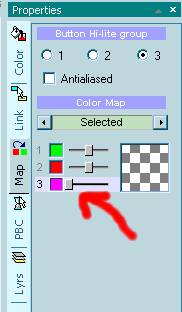

  2. Select Invisible Normal on the Link tab.
    Slide the bar all the way to the left on the Map tab.
    Cheers, Jim

  4. I forgot a step. Set transparency full, and drop shadow none:
    It will show in dvdlab, but not if you preview, nor on the finished dvd.
    Remember, if you set "Invisible normal", the image will be hidden too. It will only be visible when selected.
    Cheers, Jim

    I did as described above and it still does not work. The image I am using will not display when I highlite or click on its "location". This happens in both "simulation" mode and in the created DVD files. I have set the TRANSPARENCY slider to both "full left" and "full right". I have turned off the DROP SHADOW option. I have set the "invisible" mode to INVISIBLE NORMAL.
    I have tried the above settings on both a blank menu, and a menu with an image as the background, no difference. All I can get is the image displayed in green (or whatever the LINK-SELECTED color mode is set to).
