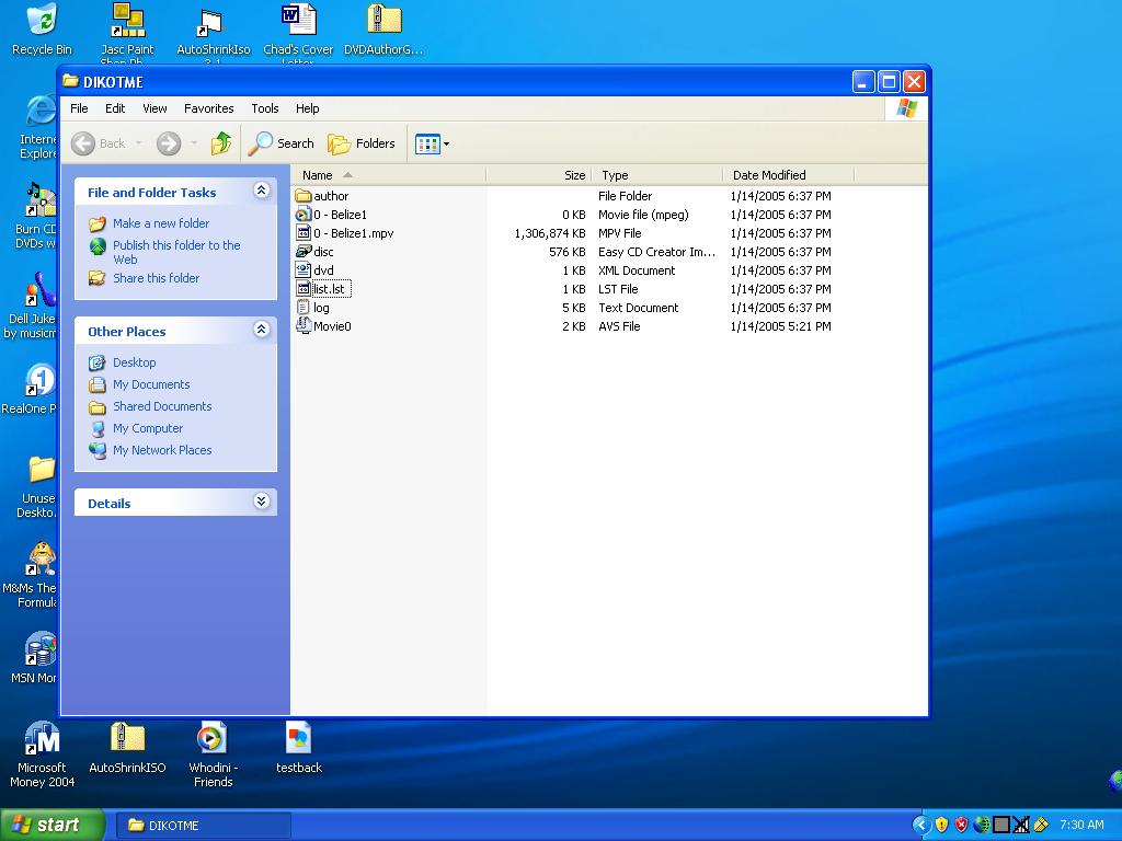

  23. Please list (or screenshot) the files/ext that DIKO made for you. When I've used it, it made both Video and audio files - .mpv and .mp2 .
    Do you see these anywhere? I put them into TMPGenc DVD Author (trial) and it worked fine.

  26. For a second there I got excited and went home to check my HD config. It was already NTSF but I also thought maybe my paging file was giving me problems so I increased it 15GB and tried one of the clips that is about 5GB and again, the results are the same...blank Video_ts and audio-ts folders.
    I posted a screenshot of the DIKO output. In the author folder there is a blank Audio_TS and Video_TS folder.
    Thanks again.

  29. In DIKO configuration, what are your settings for the "Parameters" tab? Why is there an "easy cd creator" file in your output files?
  30. Thanks for the suggested off topic replies and I will be more conservative when doing a screen shot next time. However, as to why there is the "easy cd creator" file, I have no idea. Here are the settings on the parameter tab:
    Parameter - Mode = KDVD value = true, System - NTSC value = true, Video Encoder - FreeEnc (built in) value = true, Audio Encoder - BeSweet (MP2) value = true, Media Size value = 4482 MB, Overhead value = 180MB, Ingnore Pulldown failure value = true, Remove Temp. Files value = false, Use Avisynth Monitor value = false, Interface Language value = English
