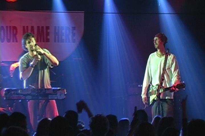

    Are the lines you refer too the same as the ones on the singer to the left in this pic? https://www.videohelp.com/forum/images/guides/p1094170/40.jpg
    If so that's interlacing and is how it's supposed to look. Once burned to DVD it will look normal, even using software designed for playing "made for TV" video on your computer will make it look normal.
