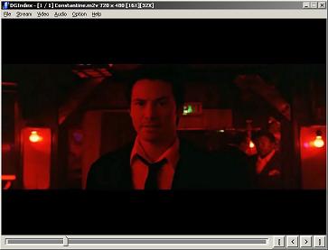

    I just realized you said that you were having a colorspace problem i.e., black not being really black in the end.
    Sorry but I somehow managed to miss that the first time I read your first post here.
    Give details as to how you capture and what capture codec you use and paste an actual AviSynth script that you are using.
    Also tell us what encoder you are using.
    - John "FulciLives" Coleman
    P.S.

  11. Member FulciLives's Avatar
    May 2003
    Pittsburgh, PA in the USA
    Are you using TV SCALE or PC SCALE in DVD2AVI or in this case DGMPGDec
    Perhaps using one vs the other will make a difference. Not sure which is correct for making an MPEG-4
  12. Originally Posted by FulciLives
    I forgot about that setting!
    I'll take a look.............It's set for PC scale, which is what i wanted anyway.
    Doesn't "TV scale" = (8-235) range?
    Well TV SCALE should be 16-235 but that is what a DVD uses anyways so maybe that is the better choice?
    I don't know much about how MPEG-4 handles things like colorspace and luminance etc. since I mostly do analog capture to DVD or PAL DVD to NTSC DVD.
  14. Here's the difference between PC-Scale, and TV-Scale;
    It looks like what i expected to see.
    It also looks just like the problem i was having. It didn't show up till i used Convolution3d.
