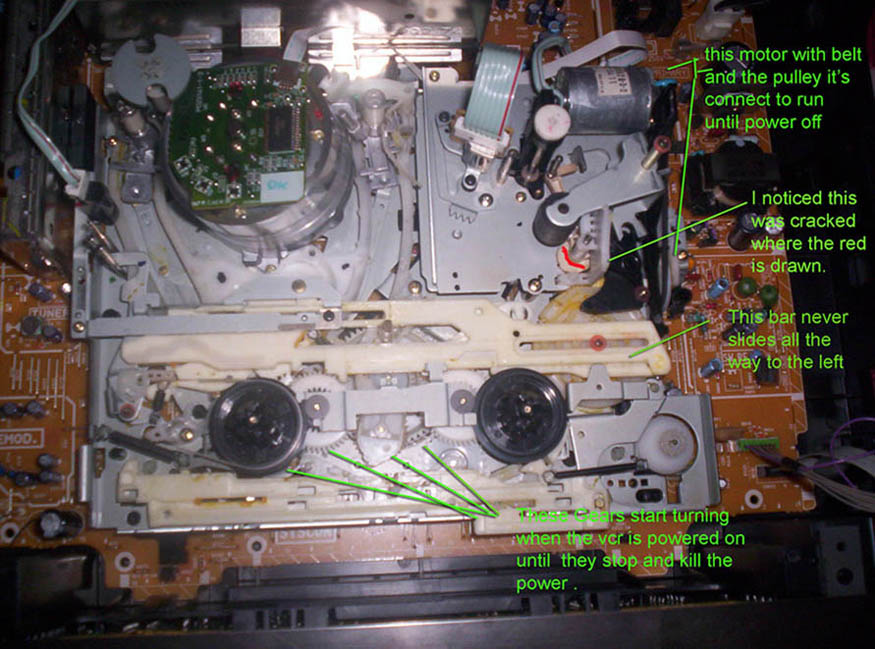

It's a JVC ultra spec vcr and the model number is HR-VP628C. If that helps any I dunno. Later I'll post pics and show details on what's it's doing. thanks

If the left reel is turning it's not the bottom belt. It sounds like it doesn't think the tape guides are back where they should be, that's probably why the left reel is turning. Pictures would help.
Here is a pic with the Tape housing off and I drew lines to the stuff I noticed when powering on. These thing run when powering on until it powers itself off after about 25 seconds. I also just noticed a little lever/sliding bar/ thinga-majigge is cracked right in half. If someone tells me the proper name I'll find another one, unless i can steal another one from another vcr. here is two pics the first is one without my explanation drawn on it so you can view the parts. the second one is what I concluded while powering it on with the top off.

There's the pics. What do you guys recommend I do to this vcr? I've been reading reviews and it sounds better than the 1996 sanyo vcr i got now. A couple of years ago I bought an expensive sony 19 micronhead auto cleaning stereo vhs and I still noticed that the sanyo I got recorded better quality than the sony. The sony was full of white specs, but when taping the same channel on the sanyo the video was clear. If this vcr can be fixed I'm thinking it would be a damn nice one to use for dubbing or as a replacement. I don't have the remote but I got a universal one with a menu button on it.
See if you can turn the pulley on the right side till the tape guides come back from around the drum. The cracked arm should come back too and the pinch roller should raise.
the pinch roller does not raise. It does move but doesn't raise. And that little arm moves a little bit . When I pull the pulley on the side i can make the white slide piece go all the way to the right but not all the way to the left. what is that piece that's cracked, called? Could I either superglue it back together or swap it for another one from another vcr?
You could try glue. It's a sort of high stress part, I don't think it will hold. You can get one from another VCR if you can find one, it will have to be the same manufacterer and the same mechanical assembly. I have one of those, I could give you the part number if you want it. Look at the tension arm on the left side, it should move so that the guides can come back. There are a couple of small plastic pieces that like to break on those and then that arm doesn't move. If it doesn't move then move it back and turn the pulley on the right side and see if the guides and arm will come back then.
