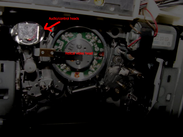

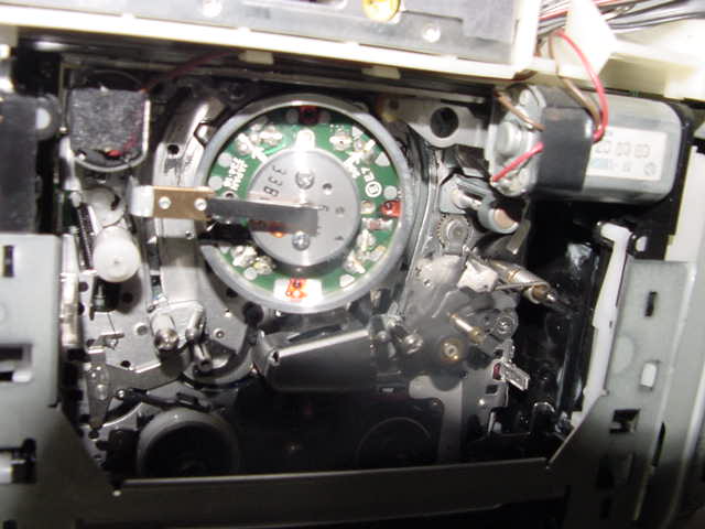

    The audio makes a helicoptor type noise and the picture looks as though the heads need cleaned. I cleaned the heads but still have unviewable picture and this audio noise. Sorry, this is a shorter version of a post I typed up before my computer crashed. Any ideas?
    *edit* Hmmm, not good. I did a comparison with my 8mm camcorder and it looks as though the tape is moving faster in my camcorder. This leads me to believe the capstan isn't turning fast enough.
  2. Clean the audio/control head with alcohol and a q-tip, that's what controls tape speed. How did you clean it? You need to use a chamois that's made for head cleaning on the video heads. The only good ones I've ever seen are Chemtronics.
  3. I cleaned the pinch roller with alcohol and Q-tip because I figured it was slipping. No change. The head with a 8mm cassette type cleaner.
  4. At risk of sounding like an idiot... Aw, why bother now... I don't see any eads other than the video frum...
  5. Upon closer review of that part, it appears to be a motor of some sort. The tape never makes contact with it. I actually dug up something that says 8mm VCRs use the video head to record the audio also.

  6. HiFi is done with the video heads. I don't know much about 8mm, but if they record in different speeds, there should be a control head by the capstan somewhere that controls tape speed.

  10. Yes, I Know Roundabout's Avatar
    Jul 2003
    ...in and around the lake
    The capstan motor is servo locked, so if it's running at a different speed, it most likely is running at LP (half) speed. Makes sense, if it can't detect the signal from the tape.
    Tell you the truth, I don't have as much experience repairing the 8mm format vs. VHS. Another guy in the shop used to fix these, I tried to stay away from them as much as possible.
    I have a similar unit to this one packed away, I haven't looked at it in so long that I've already forgotten the model #. I also have an EV-S1, semi-portable 8mm deck that still works OK.
    Most of the problems I've had with these units over the years is related to the heads getting clogged. IIRC the head gap is smaller than VHS and they get clogged with junk easily, esp if someone FF/RW the tape while it's playing.
    I have a "Lapping Tape" that I use to really clean the heads, because we found out in the shop that a normal cleaning often just wouldn't do it for these units. The lapping tape is much coarser than a normal cleaning tape, and you can't run it for more than a few seconds because it causes a great amount of wear on the heads in a short time. I have needed to use it many times on these decks, they seem to clog at the drop of a hat. When the heads would clog, I'd just pop in my lapping tape for a couple of seconds and I was back in business.
    I suspect that your heads may be badly clogged too, and it may be all that's necessary to restore it to normal working order. Of course, it's also possible that the deck is out of alignment instead
    Have you tried recording something and see how it plays back?
