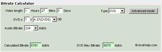

    1:27:00 DV 720x468 Video
    224 kbps MP2 Audio
    Putting on a standard DVD yields a bitrate estimate of:
    6781kbps
    So...
    I launch the encoder, choose VBR and when I input that number per the instructions on the Calc page... it says it's going to be 105% or something.
    Will the estimate be wrong? Is the calculator wrong?
    Does the calculator account for a modest menu?
    I put in 6700 to be safe. 20 hours remaining.

    According to vcdhelp bitrate calculator your bitrate should be 6058,looks like you will go over,make sure tmpg says its 100% and double check your calculation.

    What you'll find is that TMPGEnc classes a DVD's capacity as 4200MB, even though you can go pretty close to 4482MB in reality. 6700kbps video and 224kbps audio (in theory) will give you a 4412MB output, which will be fine.

    My mistake,maybe i need glasses ,one thing is you have to account for is some overhead which is usually 100-200 mb depending on how many tracks you are using.

    The calculator does not account for menus. It literally works out the bitrate to absorb right down the the last MB of disc space, so generally I'd subtract 50-100 from the bitrate the calculator like you have. This should give you plenty of space for a modest menu and will keep you off the very outer edges of the disc also. You could always enter a custom output size in the bitrate calculator too - such as 4300MB or whatever.
