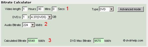

All you need to do is:
1. Put the running time in
2. Select the audio bitrate you are going to use
3. Use the Calculated Bitrate as your video bitrate
That said, I think something else might be causing your issues, such as MP3 VBR or AC3 audio. TMPGEnc for one sometimes struggles and has been known to exhibit funky behaviour when this is the case.
If you provide some details about your source file, we might be able to offer some more meaningful advice

OK. If it's 23.97fps, then you're best to keep it that way (more information in this thread). I'd suggest you take a look at my AVI 2 DVD guide, which guides you through the bitrate calculator, TMPGEnc Plus settings, and encodes to AC3 with ffmpeggui (so basically everything you're doing here!)Originally Posted by Far Beyond driven
If in doubt, Google it. -
I am doing it that way because I read your guide already. Let me say it is easy to understand for a newbie and works great! Thanks alot. I'll try these files again. I'm probably just missing something.
