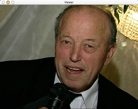

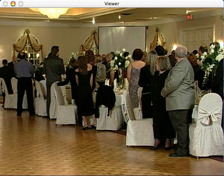

Screens from recording done with FR mode 2Hr55min:
Rich and vibrant colors, deep blacks, sharp and detailed images without digital artifacts and macro blocks. -
That image is too dark. There are no highlights. Darks (like brown hair) have turned to solid black. After recent research it has come to my attention that Panasonic is simply darker than it should be on encodes. That's the sole reason so many Panasonic fans think other machines are "too light" when it comes to image quality.
I further suggest that Panasonic has NEVER EVER fixed their IRE problems. What they have done to "correct" the issue is to allow the user to augment either the gamma or the luminance. Not the IRE. The results of such a change is that, while the "black level" is put to a darker tone, so are the lighter colors and whites. Furthermore, augmenting in this method would likely give the false appearance of "richer" colors, as darkening an image gives false ideal of "enriching color".
That really solves some of the mystery of Panasonic image quality. A lot of it is false, and gives users false impression of other machines that can truly do a better job.
The TIPS and TRICKS ... aye, TRICKS ... can help you, but it will never 100% correct these machines, not until Panasonic decides to entirely re-design the units from the ground up. They simply messed up so many years ago, and have been too lazy to fully correct their years-old mistakes.Want my help? Ask here! (not via PM!)
Since you didn’t see the original image captured on tape, please don’t make pointless and useless assumptions.That image is too dark. There are no highlights.
Darks (like brown hair) have turned to solid black. -

Thanks zorankarapancev for posting those pictures...I see our favorite Panny basher is back criticizing again. Typical propaganda comments against Panasonic. These images are fine..Far superior to anything by that JVC crap and guess what...no loading problems!!! Some day he will wake up or maybe not.
