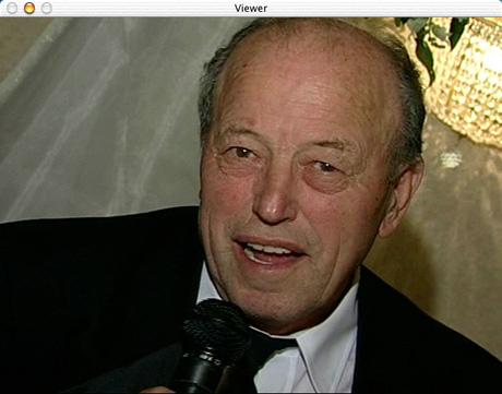

Screenshot from 2Hr and 55 min FR recording:
Results 1 to 30 of 155
I wanted to insert two screenshots that shows the picture resolution of 704x480 at 2Hrs and 55 Min, but for some reason it is not working.
