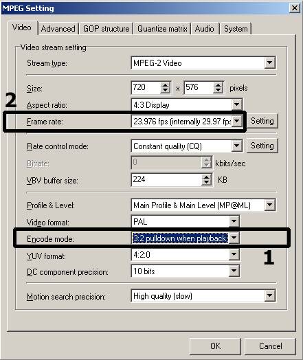

    You have to include teh 3:2 pulldown setting when you encode to be able to use 23.976.

    As Forum Troll said, do this:
    1. Set the Encode Mode to 3:2 pulldown when playback
    2. Set the Frame Rate to 23.976fps (internally 29.97 fps)
    TMPGEnc DVD Author should now accept your file.

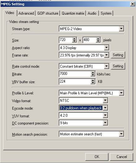

    The ones in the screen dump I posted won't work - most of them are PAL settings - I just changed the two key ones as an example for you. Give me a minute ...
    EDIT:
    OK.
    Set it up like this:
    If in doubt, Google it.
    merseyside
    i've never had this problem before.i cant understand why using 25fps causes video pauses.the only way i can get it to convert is if i use the settings given using encode dropdown,is to drop the reso to 720x480
    merseyside
    thanks,thats the way i had it to get it convert,thanks again for your help.
