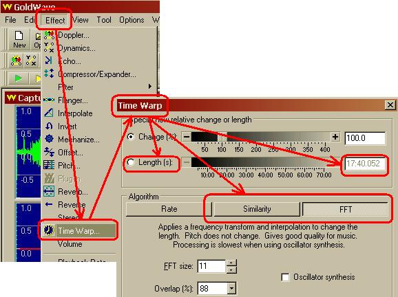

    Use Gold Wave as before to get your audio. Once you have it, select Effect=>Time Warp, and either FFT or Similarity (to keep the pitch unchanged), select and change the length of the audio file to match the video. Save as wave. Voilá!

  4. okay cool! but then what do i do with the wave file? do i remultiplex it with tmpgenc? can i just reencode the avi again using the new wav file or do i change it to mp3/AC3 using a different program? thanks a lot!

    Yes, use the main TMPGEnc Plus! screen to load your video and wave files, then select the proper template for your MPEG file.

  6. okay so i changed the file length using goldwaves timewarp like you said, and now i am going to reencode using the original .avi file for video, and the new wav file for audio into system (audio+video). i hope this is right! i will tell you how it goes, thanks for all the help tommyknocker
