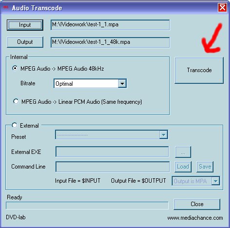

When you click OK, DVDLab will demux the file, then prompt you to run "Audio Transcode"
Just click YES, then click the transcode button.
When it's done, the transcoded audio and corresponding video will be in the assets window.

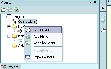

Right click in the project window, and select Add Movie.
Add as many as you need. One for each movie, or part of a movie (each mpeg you want on this dvdr). Don't be afraid to add more than you need, you can delete ones you don't need, by highlighting them, and hitting the DEL key on your keyboard.

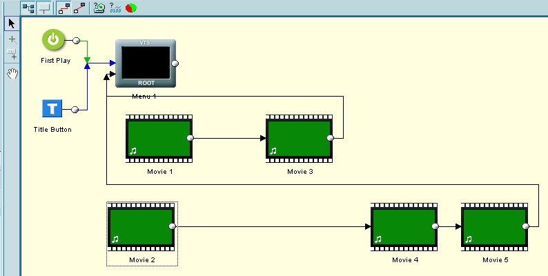

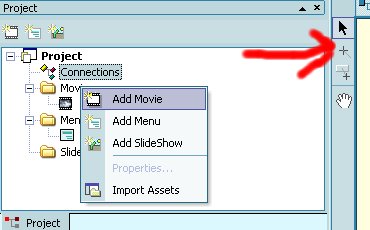

Once you have all your video, and corresponding audio, in the Connections window, it's time to link things properly. If you have any video that is in two or more parts, join them now. You do this by selecting the Draw Links button (the + beside the project window)
Click on the first part of your movie, drag, and drop on the second part of your movie. Do this again from part 2 to part 3 if necessary. This will make it play as one continuous movie.
In my example, I have 2 movies, the first is 2 parts, the second is 3 parts, and the image below shows only one way you can link them. As I have it, movie 1 and movie 2 are the beginning parts of my movies. How you link the remaining parts is up to you, as long as you don't link part 1 of movie 1 to part 2 of movie 2. Keep things organized
