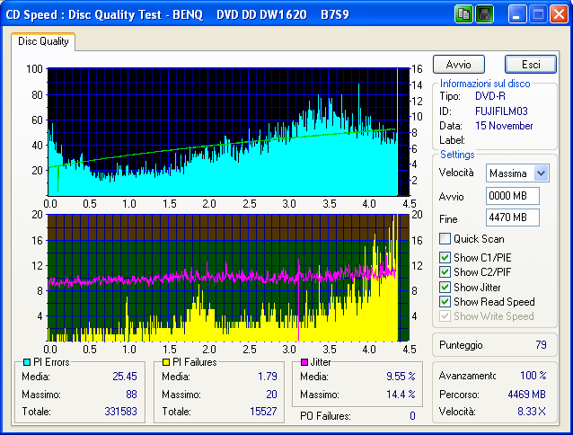

I already used the datawrite classic grey 8x with ID Fujifilm03.
These are the result :
[/img]scan2.png[img]https://www.videohelp.com/forum/images/guides/p1166012/
Looking the scans, isn't really better the CMC one ?
Furthermore, all the times I tried Fujifilm03 at 8x i had a coaster !
They worked only at 4x .[/img]Minds are like parachutes. They only function when they are open ! -

this is fujifilm03 scan :
