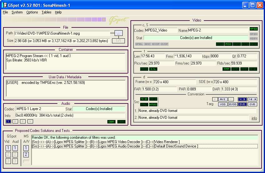

  9. Here is a screen dump of the source file as evaluated by GSpot.

    @jimmalenko: Can you tell me anything from the snapshot of the GSpot screen that I have provided for the source file? I do have the licences for the Ligos Indeo XP Video 5.2 Codec. If I understand the GSpot screen correctly, it implies that what ever is necessary for preparing the DVD, is already provided in the MPEG file. Am I totally off the track??
    The GSpot pic looks fine to me. I think there must be something wrong with the source file
