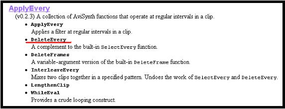

  9. This is along the lines of what i was thinking;
    http://www.avisynth.org/stickboy/

    That would work if it takes 199 parameters.
