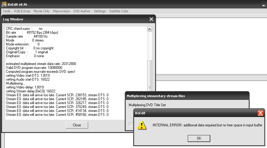

    Hi jimmalenko,
    Thank you for the guide, but I'm having problems following it. Could you please tell me what I'm doing wrong?
    In the 2nd field where I locate the audio file, I only see "VTS_01_1.c0.mpa" and nothing else (no AC3 files).
    Then after pressing OK, first I get an error message (see screenshot) and then another error message saying "Too many frame drops!"
    Please advise me on how to fix this issue. Thank you for your time!!
    L
