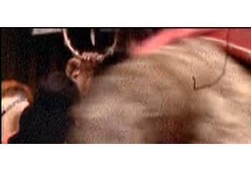

    Any tool to remove this ?
    Of course, it's not on every frame.
    Many thanks.
